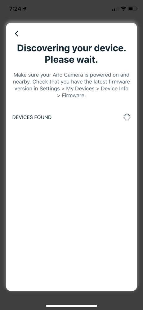

Brand new Arlo Pro 2 & base-station cannot connect to / discover HomeKit, out of the box.
I've been through phone-support twice since receiving my Arlo Pro 2 cameras on Thursday night, but am hoping I can expedite the solution as I'm now waiting for a Tier 2 support person to call me back as none were available tonight...
How the issue manifests:
After setting-up both Arlo Pro 2 cameras & Hub (VMB4500r2) via the Arlo app on my iPhone, I went to setup the HomeKit integration via the Hub's settings. However, I perpetually see the 'Discovering your device. Please wait.' screen instead.
Troubleshooting steps taken:
- Reboot Arlo Hub (via app & power-cycle)
- Reboot Arlo Pro 2 cameras (via app & power-cycle)
- Reboot home WiFi (via management app & power-cycle)
- Soft-reset iPhone
- Uninstall & re-install Arlo app
- Use second iOS device (iPad Pro)
- Restart Apple HomeKit Home Hubs (Apple TV, iPad Pro, and HomePod)
- Confirm all Apple hardware is up-to-date with software
- Confirm all Arlo hardware is up-to-date with software & firmware
- Confirm all devices are on same WiFi network
- Confirm all existing (25+) HomeKit devices are connected & responding
- Place cameras, Hub, and iPhone within inches of each other
- Leave iPhone on above 'Discovering your device...' screen for 30-45 minutes
Arlo support experience:
I've been on two different phone calls with Arlo support, which (to be honest) has not been fantastic. I've spent about 90mins on the phone on two different days, and spent about 50-60mins of that on hold. I've repeated all the steps numerous times, and the very first email follow-up I've received just tells me to follow the KB article on how to set-up HomeKit...
I'm now waiting for a Tier 2 support engineer to call me back 'within a few days' as none were apparently available tonight.
I've done plenty of my own research both here, as well as on the /r/arlo subreddit, and it does appear this is a known issue with a number of Arlo Pro 2 kits, wherein the Hub needs a new Apple HomeKit Certificate issued remotely, with many saying they can have this resolved once this is confirmed within 20mins.
I'm hoping that someone (perhaps the fabled JamesC of this support forum) can help me in resolving this...
Many thanks for any help you wonderful people can give!
