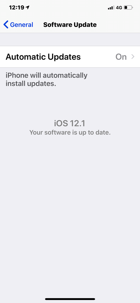

Hi I have just got the new iPhone XS max and it is synchronised to my cameras but it will not play my library videos but will play live events can you help please
I don’t know what the reference to beta 5 is.
I have an iPhone X s max. With IOS 12.1 installed.
My video captured from movement on camera will not play.
My wife who has an iPhone 6s Plus also has IOS 12.1.
The same videos play on her phone.

OK, how could this person have 12.1 installed if it's not releasing until next Tuesday?
