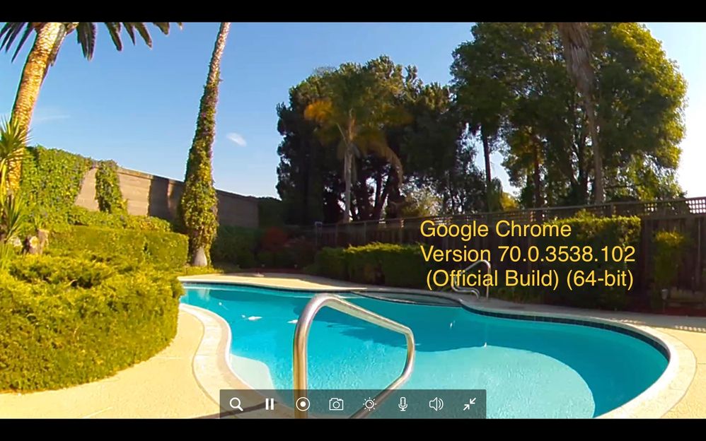

I wish I could help. This is what I see on my MacBook Pro 2016.
Image using Chrome browser.
