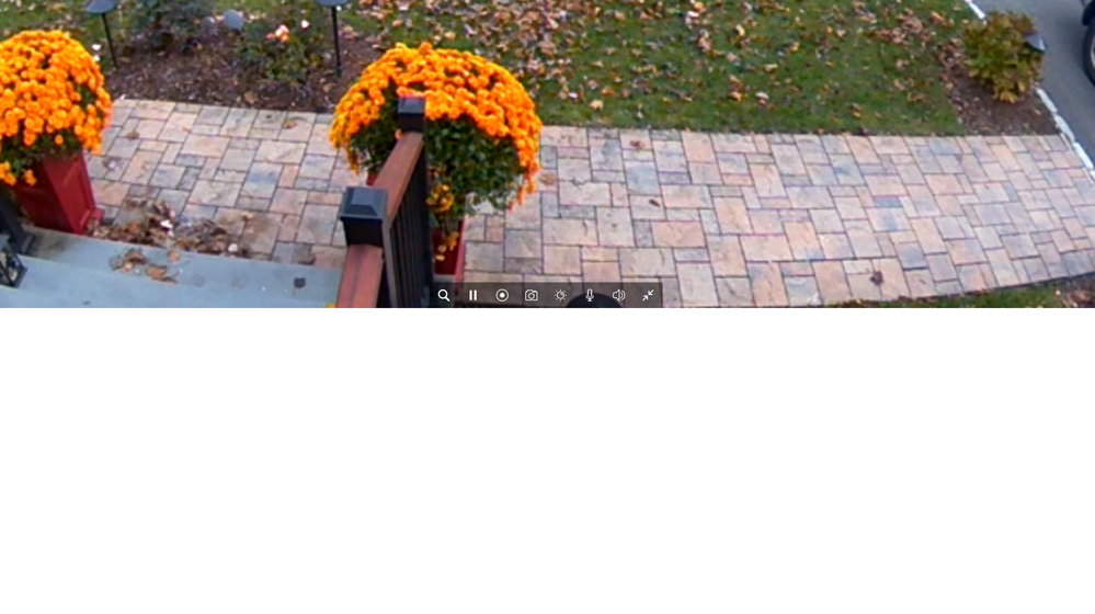

Hello. I recently installed two Arlo Pro 2 cameras. They appear to be working properly, however, when I access live view from a Mac laptop or desktop running OS 10.13.6, I am able to see the full view when the screen is minimized, but when I expand the view, only bottom half of camera frame appears: the bottom half of the camera frame moves up and the bottom half of the computer screen is blank (see image, below). I tried resetting the base station and removing, restarting, and reassociating the cameras, with no change in what's displayed. I do not have this issue with the expanded view on an iPhone running iOS12.0.1. How can I resolve this problem? -- Thanks.
Expanding view reduces display area
That worked. Now I can open Chrome and go right to full screen view. Thanks.

Same deal as all the rest of you. Only getting the bottom half of the screen. Works fine using Firefox but not Safari. I hate Chrome (and won't use it) because of having to approve Flash Player everytime I want to use the Arlo site. Spoke with support a few days back and got no resolution at that time. I'm using a Macbook Pro with Mojave and have updated everything there is to update. Never had this problem before. I have 9 cameras, 7 solar panels and up until now have had virtually no problems. But NOW.................. 😞
What absolutely kills me... is to fix safari, all they have to do is turn off in the transform line in the CSS... But now it's been 2 weeks and they haven't fixed a simple problem. (see screenshot)... Come on Netgear... IT SHOULD BE A SIMPLE CSS CHANGE!!!
Or if they MUST do this, then target safari differenly... i.e.
-webkit-transform: translate(X, X%); /* Safari */
It's not rocket science.

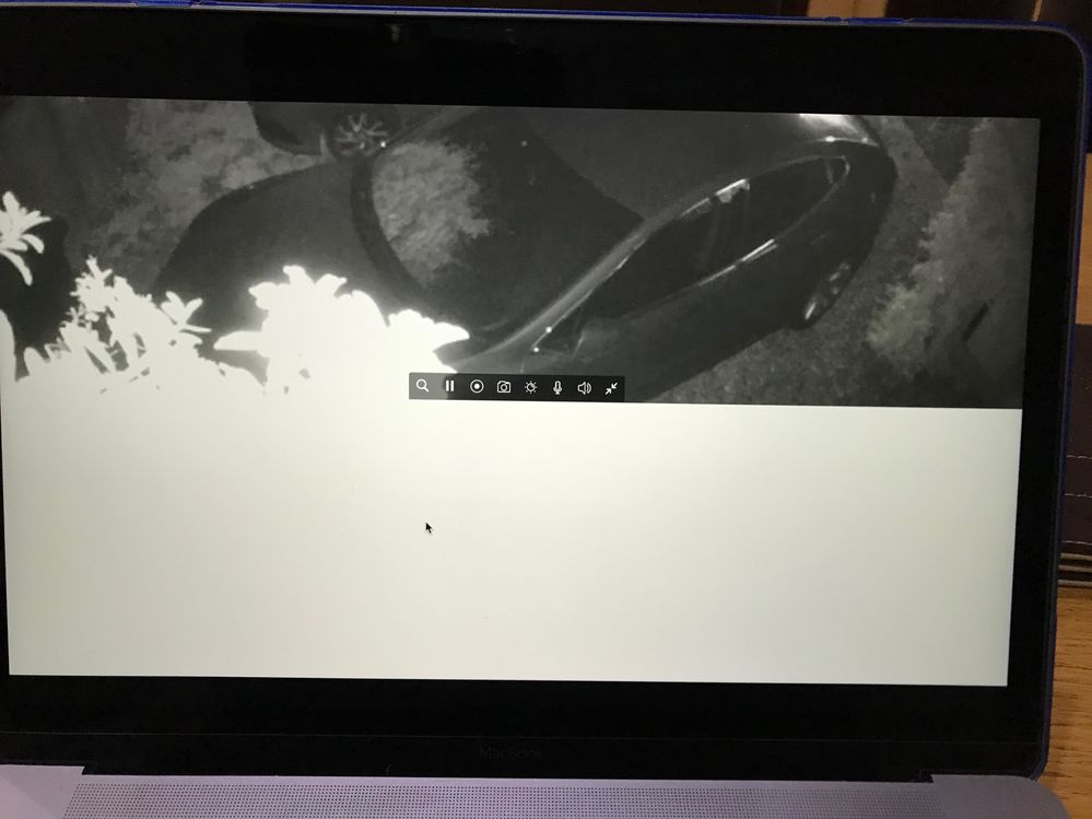

I am running OS Mojave, 10.14 on a Mac Pro And a MacBook Pro and I am having the same problem. Whe I go to full screen, the image is displayed in the top half of the screen. The image is only the bottom half. A solution would be nice. I am running Safari. Works fine on my iPhone. My images look the same as jscirocco.
I continue to be unable to view my Arlo Pro 2 cameras in full-screen mode via the Arlo website using my Safari browser. (All Arlo Pro 2 cameras and the base station are running the latest firmware). My experience has been the same as many others have already stated in that only the bottom half of the screen is displayed in the top half of the browser window. The bottom half of the browser window is blank/white space. This only happens on my desktop computer using the Safari browser. Full screen view via the Arlo app works as it should on my mobile device.

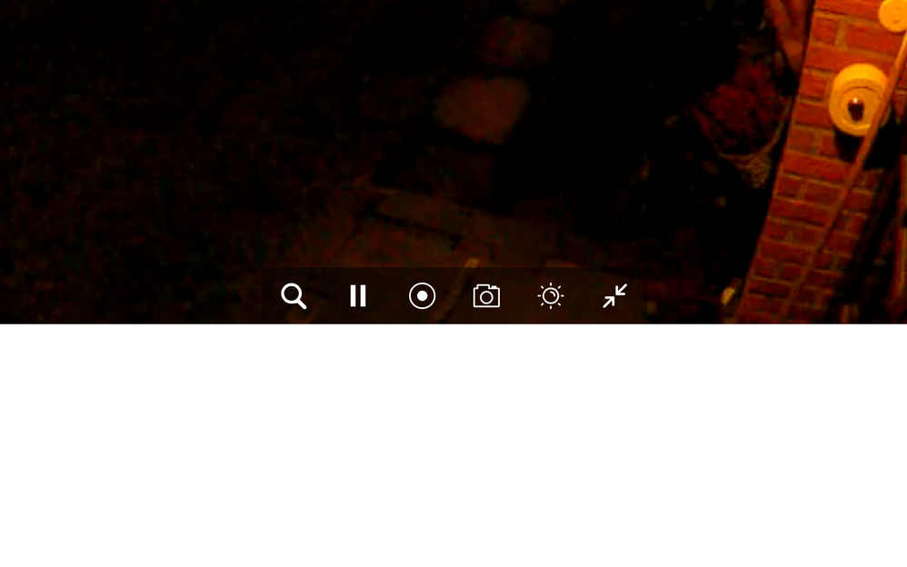

When viewing any of my cameras in MacOS 10.12.6 using Safari, the view gets cut in half. A large white band is on the bottom of the view. Does not do this in Chrome web browser. Been happening the last week or so. Does not do this in iOS on iPhone either. I have included a screen shot to show what is happening. Restarted computer, cleared browser cache as well. Firmware on Arlo Pro (H8) is 1.092.0.19_26228; firmware on Arlo Camera (H7) is 1.3.314; firmware on Arlo Q (VMC3040r6) is 1.9.0.0_269; firmware on base station (VMB4000r3) is 1.12.0.0_27099.
