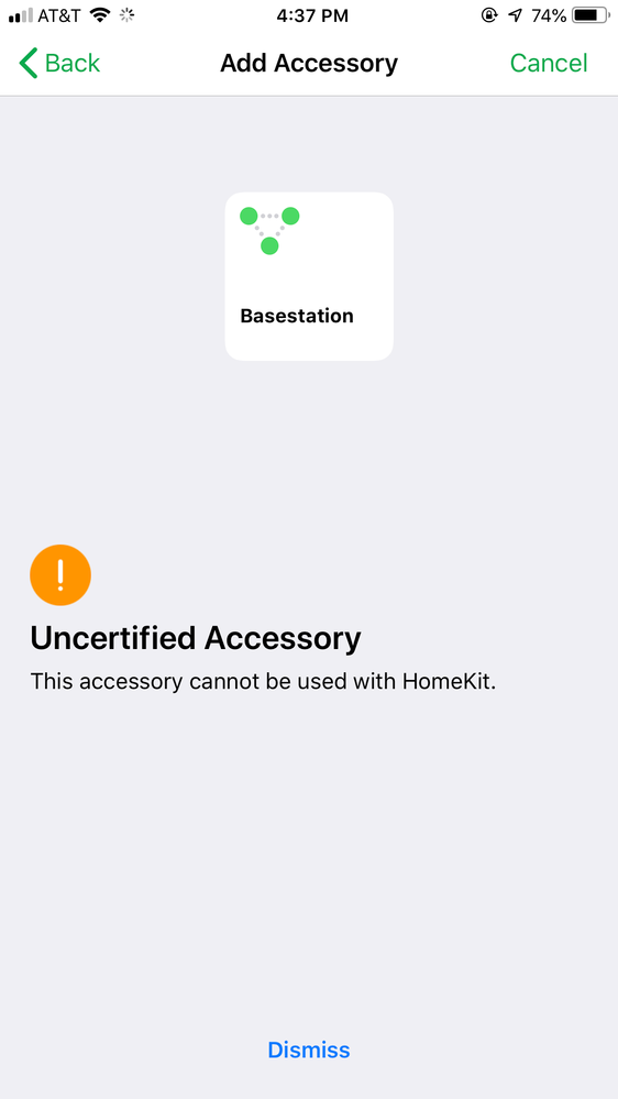

When is HomeKit capability coming for the VMB5000??
It seems ridiculous that your latest hub and cameras are not HomeKit compatible.
Massive failing.
It comes down to the base station that you are using.
Only two are; VMB4000 and the VMB4500
So, if you are a stupid like I am and purchased a later version following Arlo’s announcement of HomeKit support (at the start of this year) then you are out of luck. However, standing applause to Arlo by not announcing the finer points - i.e. that the newer releases of their range wont be HomeKit comparable within a realistic timeframe.
Arlo CEO indicated Q4 for release of HomeKit for the Ultras...you just need to hold onto your 4K a little longer. ![]()

I’ve tried setting my homehub, reset my base station, reinstall the app; etc. No success so far.
