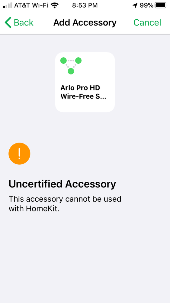

Exactly the same issue with HomeKit here too showing the 'uncertified accessory' error here as well.
I've even tried a base station restart/ full reset / delete app etc but still have the same issue.
Does anybody NOT see the device uncertified warning? It appeared at the initial setup, I think and it shows up in settings for the cameras in HomeKit.
