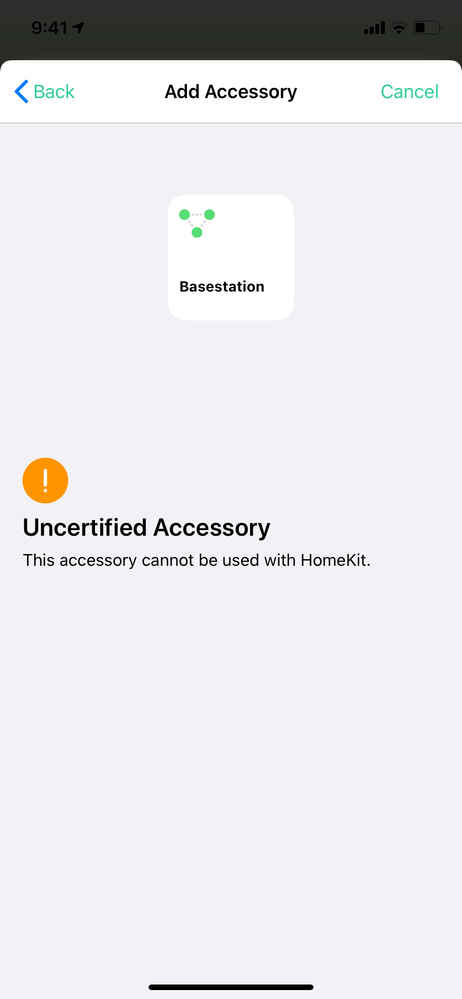

I am having this issue of uncertified accessory when pairing with HomeKit. I have attempted to use the Live Chat function on your website but was unable to find a solution with the technician.
I asked if they could resend the token as this seems to fix the issue for others on this thread, but they told me they were unable to do that. Attached is the image I also sent to your online support showing the problem,

I've sent a token reset request to your base station that should resolve the issue. Please reboot your base station (remove and reapply power) allow the base station to come back online and try setting up HomeKit again using these instructions: How do I connect my Arlo camera to Apple HomeKit?
Thank you! I’ve been trying for months to add it to HomeKit and it finally worked!
Thanks James! Worked first go!
