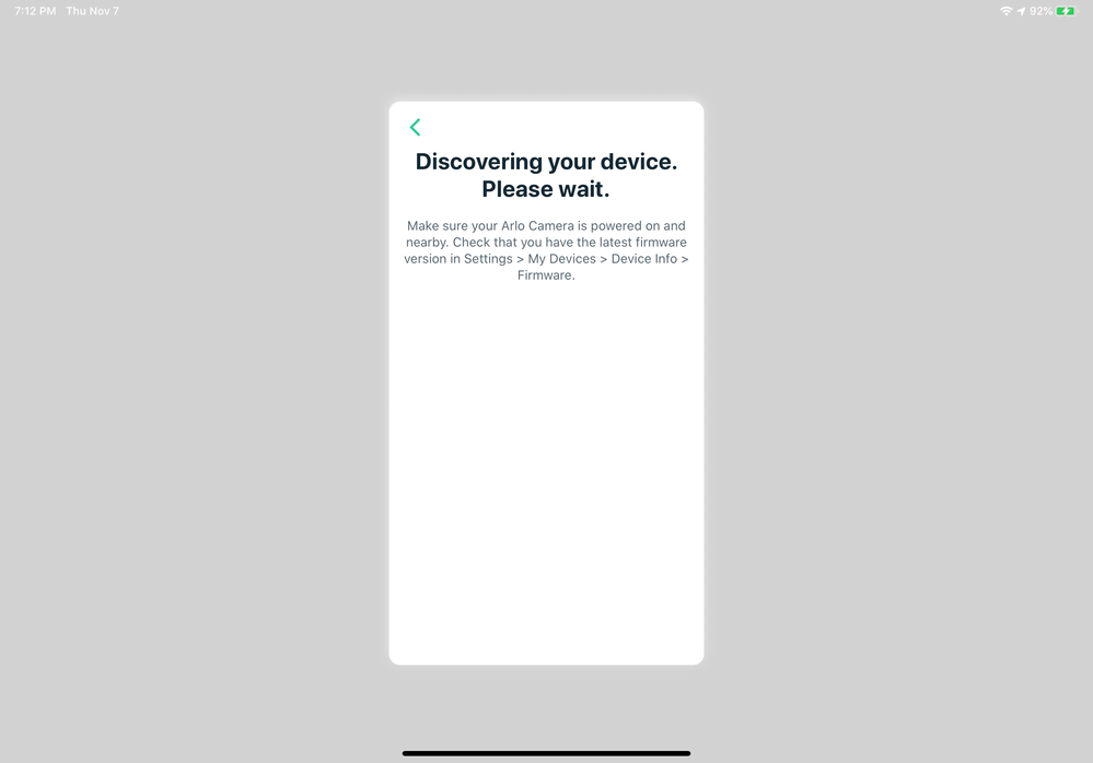

Check both my iPhone and iPad both the same under Arlo app, HomeKit and discover no wheel , nothing there see attached

Interesting, away from home I see the wheel turning looking for device , at home no wheel?
Ok just did , let’s see....
