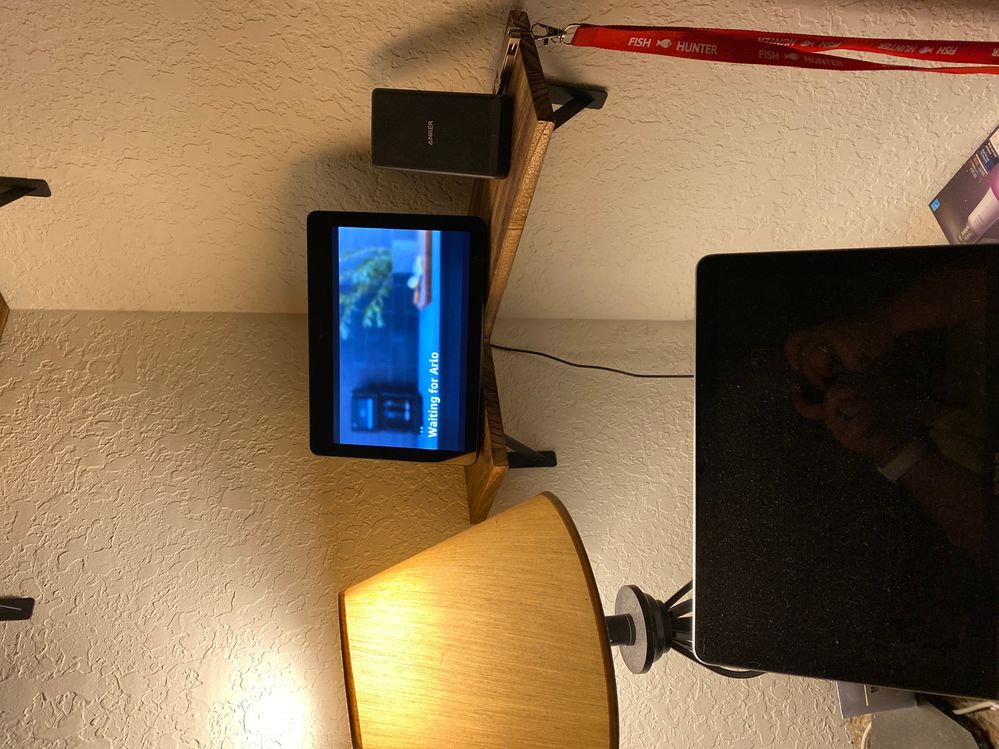

I have the same issue as everyone else. When I tell Echo to Show Garage Camera the Echo Show screen says "Waiting on Arlo"
What I found is when I login to my.arlo.com and click on a camera to play it from a browser, then ask Echo show Garage camera and it works and shows up on the Echo Show. It looks like an authentication issue.

This worked for me as well! I went live on one of my cameras on the Arlo app and at the same time asked Alexa to show me the that camera on my Echo Show 5 and it connected! Maybe now that Arlo will see this and can apply a fix to it. Fingers crossed.

I get "waiting on Arlo" NO sound, Nothing and ....... back to home screen. Tried different cameras but it WILL NOT WORK.

Echo Show (1st Generation) does not display Arlo video..... when asked to “show front door” it says “waiting for arlo” and never connects. It will say “motion at the front door”. We also have a fire tablet....it will connect to the Arlo through the Alexa app, but when it connects you can hear what is at the front door
