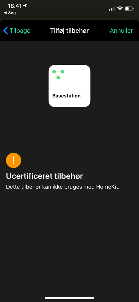

Hi james how do I get the new token as I having the same issue?

YellowRabbit, Isobaric, FrederikNissen
I've sent a token reset request to your base station that should resolve the issue. Please reboot your base station (remove and reapply power) allow the base station to come back online and try setting up HomeKit again using these instructions: How do I connect my Arlo camera to Apple HomeKit?
Thank you, that fixed it...!
