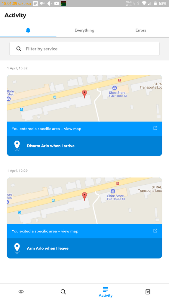

Works for me, installed it last night, it properly activated Arlo as it should (Android) when I left home today.
Will see how it behaves when I get back home, but this might be the only reliable workaround for as long as Arlo doesn't get their geofencing done properly, sad to need that as a viable option for a failing feature.
And sessions timeouts are irrelevant here as ifttt logs on to Arlo web on its own to switch the state.
JP.
Just got back home, ifttt just did what it should 😉
I can live with that for now.
JP.
@Jefffromtexaswrote:
IFTTT doesn't work for me either-Android.
Are location services enabled ? Did you give IFTTT location pernissions ?
I can't see why it would work on my end and not on others... screenshot shows IFTTT doing its job today.
JP.
