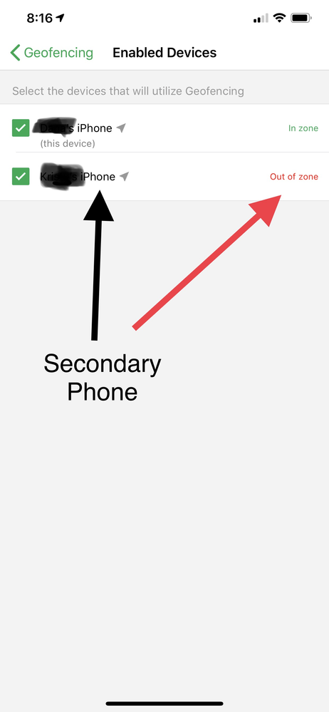

Im still having issue today (6/11/2019). Geofencing Enabled Devices are 2. My phone says "unavailable". My wife's phone is in zone. I have set Arlo to Armed IPhone to Location NEVER, shut off phone and then reset Iphone Location to Always and Arlo to Geo. NO differece. Why is it that Arlo Support isnt on this forum assisting and solving vs the group. Im only goinng to put up with this crap for a couple more days and then going back to ADT that has a responsive Support Group........
As of 6/12/19 at 8:00am EST, it seems that Geofencing is NOT working again for me. It seems that my secondary iPhone yesterday did report “Out of Zone” correctly, and when my device left for the day it also reported “Out of Zone” and the system armed Away Mode. However once my wife returned home with the secondary device, the device showed as “In Zone” but the Base Station did not set the system back to Home Mode and disarm properly.
As of today 6/12/19, the secondary device is still showing as “In Zone” when it is not, as my wife left for work at least a hour ago.
So sadly, Geofencing is definately still broken.
