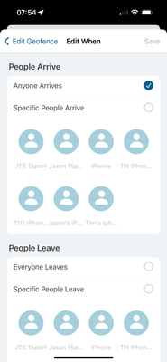

Sometime in the last few months suddenly a device is appearing twice, which is preventing the automation from working properly.
I have completely removed the individual and added them back. It makes no difference. As soon as they accept the invitation, it displays 2 iPhones in the automation.
BOTH of the iPhones displayed are the exact same person.
I have to GUESS which is the right one to get the automation to work correctly.

Can I please get screenshots of the duplicates within arrive and leave as well as a screenshot of the privacy center. Can I get the iPhone model and version. Friend's/guest access mobile devices that should appear in automation? You can Dm me all this information.

Can you all dm me your iPhone model and version. As well as screenshots of the duplicates when setting up Arrive/Leave, screenshot of the Privacy Center, friend's/guest access mobile devices that should appear in automation. Thank you!

Can you send me iPhone model and version. As well as screenshots of the duplicates when setting up Arrive/Leave, screenshot of the Privacy Center, friend's/guest access mobile devices that should appear in automation. Thank you!

I deleted one of the duplicate phones using the web app, and perhaps selected the "right" one because things started working normally. No duplicate iPhones, and geofencing worked as expected. Then I changed the "When everyone leaves" automation to have no action, since I didn't want to arm the security system while workers were in the house, yet both my wife and I were away. Now, though I see both my and my wife's phone in Privacy Center (with no duplicates), only my wife's phone shows up in the Arrive/Leave automations. I went from 2 iPhones for me and 1 for my wife showing up there, to 0 iPhones for me and 1 for my wife showing up. Any hints on how to get my iPhone to show back up in the Arrive/Leave automations?
@BrookeN The geofencing worked for about 5 days then stopped functioning. Still see my devices listed and have them selected correctly in the automations. Of course have verified phone location and other settings are unchanged and correct. Have installed and reinstalled application. Rebooted hubs. No luck. Have been reading threads for any suggestions. I am stuck. Any suggestions would be greatly appreciated. One of the reasons upgraded my camera system with the alarm system was because of the geofencing. I hate to lose use of it. Thank you for your time.
UPDATE: I deleted one of the duplicate iPhones in the web app, and things started working. But then, though I had no duplicates in Privacy Center, I only had Linda's iPhone in the Arrive/Leave automations - "Steve's iPhone renamed" was completely missing. Then overnight, things changed, and the next morning, I once again had duplicate iPhones in the Privacy Center, but only my and Linda's iPhone in the automations (which is what one would want). I renamed one of the duplicates in Privacy Center to "Steve's 2 iPhone renamed" and the results are a) "Steve's iPhone renamed" and "Linda's iPhone" in automations as shown in mobile app, and b) "Steve's 2 iPhone renamed" and "Linda's iPhone" as shown in automations in web app.
