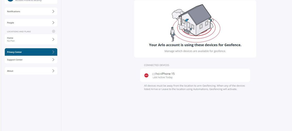

(Names have been blurred in the screenshots - the weird looking text is me hiding names, not a bug in the app)
In the iOS app, I see my phone as a person to use for geofencing.
On the website, I see it too.
On the privacy screen of the app, I see the old devices that have already been removed.
It seems like the device list is cached somewhere and not updating?
