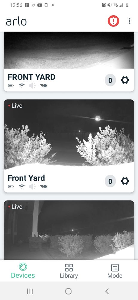

Ac power has been disconnected from your Arlo device.Activity zones are currently disabled. and a red circle with a ! in it shows on both the Arlo pro and the Arlo pro 2. We checked and they are online and the power is NOT OFF. Any idea whats wrong?
Made font size smaller on phone. After you punch the OK a dozen times, the camera comes up. As soon as you close the app, it reverts back. Of course, everything on my phine is now too small to see. This is BS

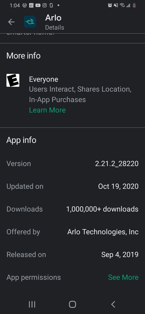

A new version of the Arlo mobile app is available form the app store that resolves this issue. Please make sure your Arlo mobile app is updated to the latest version available.
Arlo Android App - 2.21.2 - 19th October 2020

The above suddenly appeared on all my four camera displays. Won't even let me push the green "OK" button! I've uninstalled and reinstalled the App, still the same is happening. Android Huewei P20 Pro phone being used for a year with no problems. Help please. Regards Dave.

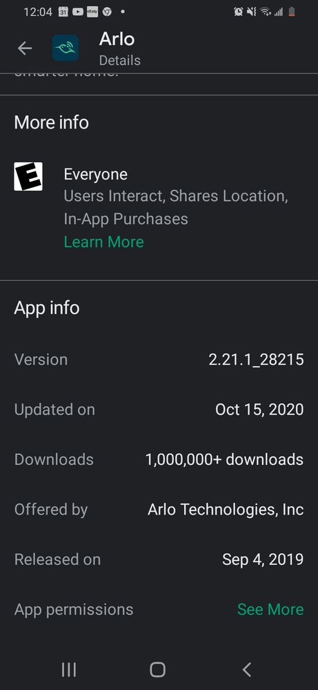

Did you get this issue ever solved? We have the same problem now since the latest firmware update. I uninstalled the App already twice, deleted the cache, but nothing helped to get rid of those messages. They come back on all device screens.
I am sure it has something to do with the firmware update, that happened on 16. Oct, because that is when the issue started. We have two systems and the Apps for both systems run on Samsung Cellphones/Android.

app which was an update to the one I had earlier.Its the 2.21.2xxxx. And the app
is now working again. Will check it after a few hours to see if it still works. Fingers crossed.
