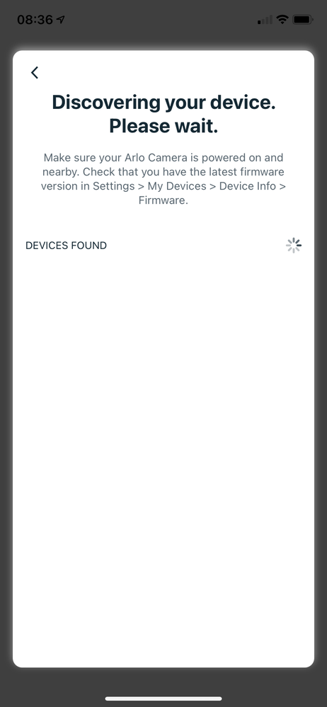

I have a similar but different issue. I see the HomeKit option and can click it. However, the Arlo app then searches for my HomeKit compatible devices and just gets stuck. It never leaves this screen (screenshot attached). Never finds my base station or cameras, but also never gives an error message.
I am trying to set up HomeKit and on the "Discovering your device" step, the app just hangs there with "Please wait".
Have verified firmware, as well as power cycled all devices (bridge, router, iPhone). I also reinstalled the Arlo app. From what I gathered, it sounds like I need a new token sent to my base station, can someone assist? thank you.

@JamesC, it didn't fix my Arlo. The instructions are confusing, by the way. Is my iPhone supposed to be near to the base station (I assume that this is what Arlo intends) or near camera? In several instances, the instructions refer to having "the Arlo Camera powered on and nearby."
