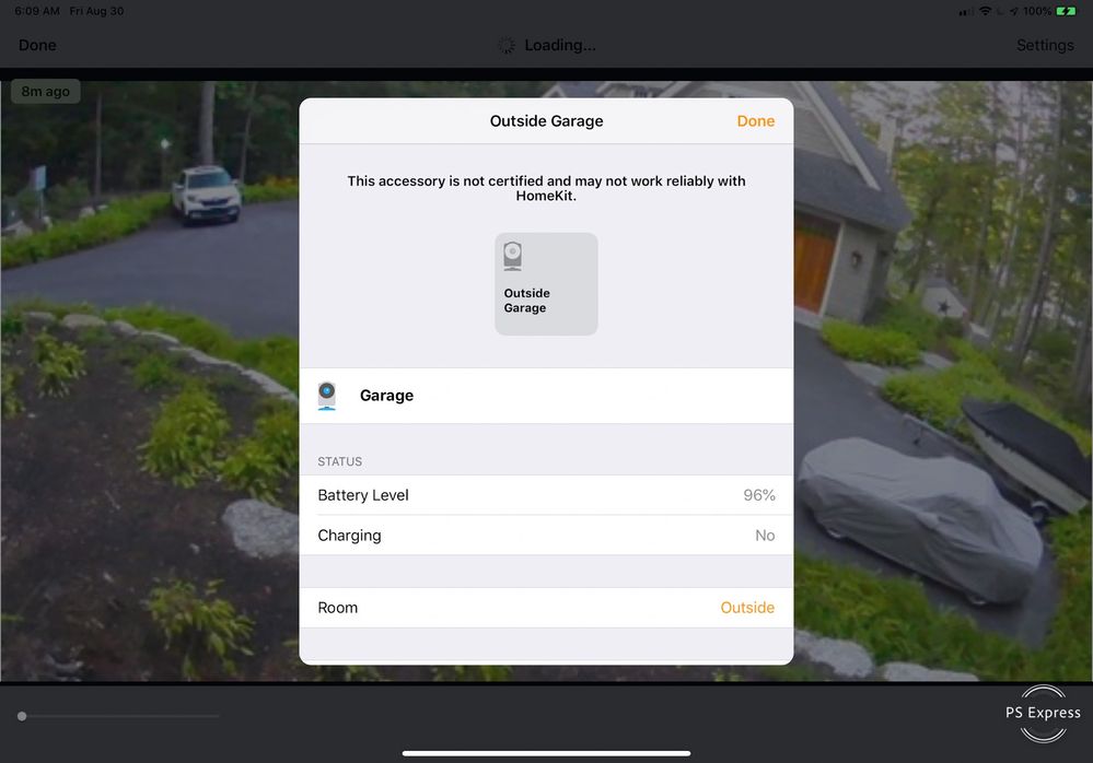

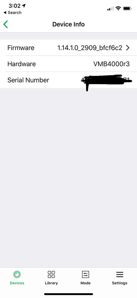

After seeing that a firmware update was being pushed out, I restarted my Basestation and the update was applied. I also rebooted my iPhone. HomeKit was still showing but I’m still getting the “Uncertified Accessory” error. Perhaps there will be an update to the app soon. See screenshot showing new firmware.
My three Pro (VMB4000r3) base stations all updated to 1.14.1.0_2909_bfcf6c2.
I still see my Pro and Pro2 cameras in HomeKit. Cameras attached to one of my base stations still show in HomeKit as being “not certified for HomeKit”. Cameras attached to the other two base stations do not report this problem. The “offending” base station is in the same house as one of the “non offending” base stations. I see no mention of HomeKit in the Arlo app device settings for any of these devices.
