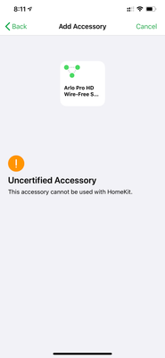

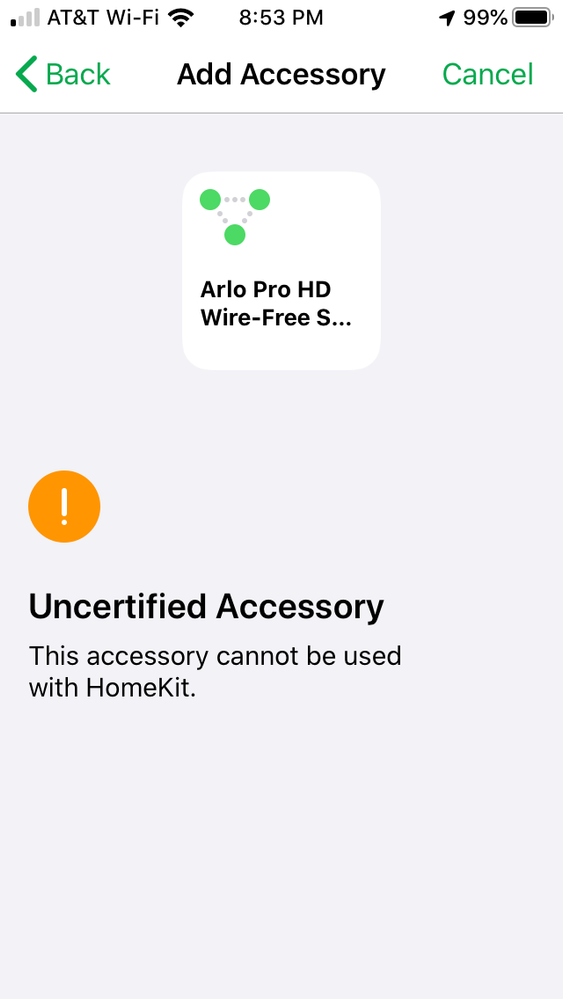

I have same issue when adding basestation/cameras to HomeKit- “Uncertified accessory”.
I had tried to add the basestation/cameras with resetting everything.
* Basestation - VMB4000r3 w/ latest firmware
* Apple TV - 3th & 4th generations
* iPhone/iPad (either iOS 12.4/iOS 13 dev/public beta)
* Arlo App - latest version
* Arlo Cameras - Pro 2 x 5
Hope can get a workaround / resolution soon from Arlo support.
