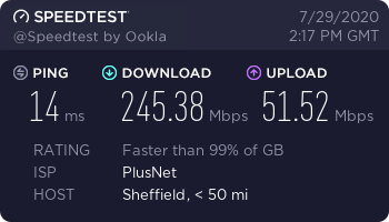

bpullen
I'm also experiencing this issue. I really hope fixing it doesn't end up as protracted as the last time!
  • Do the cameras work normally work through the Arlo app?
Yes they do.
  • What is your upload and download speed results from SpeedTest?
    9831247252
  • When did this issue begin? Did it work ever since then?
First noticed a week or so ago and hasn't worked since. It was working fine and has been since the fix back in March.
  • Are you on local WiFi or cellular data when trying? Is there any difference that happens between the two?
The problem occurs whether on home Wi-Fi or cellular.
  • When loading the camera fails, does it spin or attempt to connect, or does it show "Not Responding" right away?
It attempts to connect for a few seconds then returns a 'Not responding' error.
