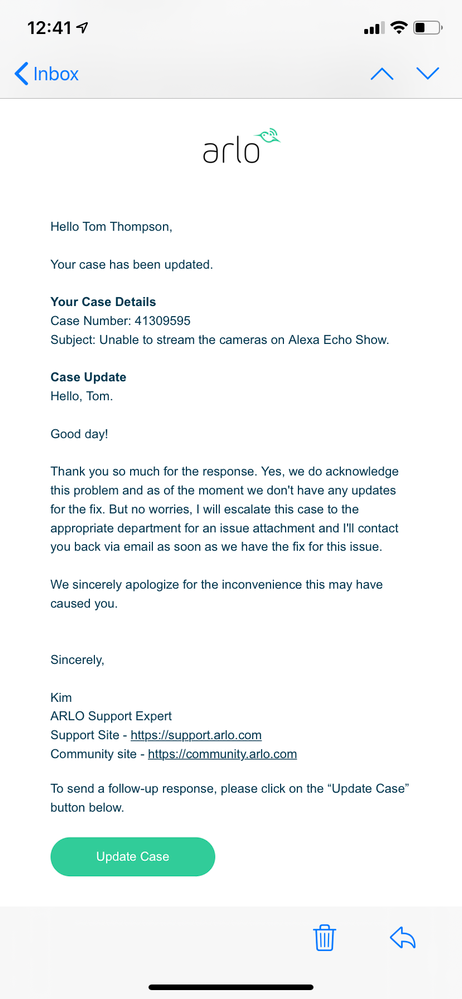

Thank you for posting this. Glad Arlo has acknowledge the issue.
