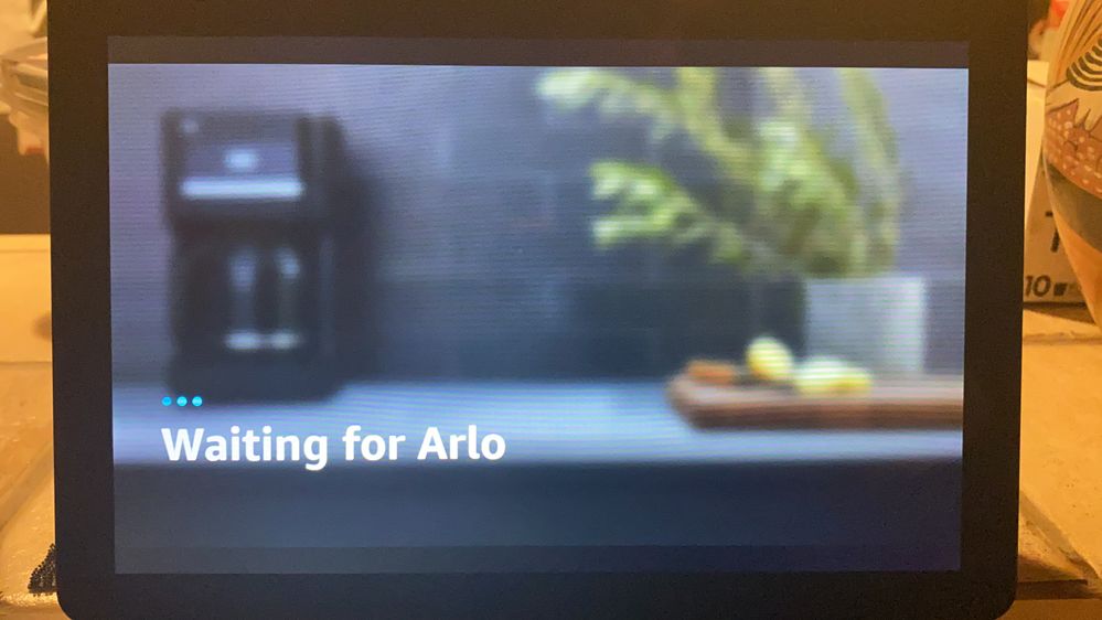

Amazon Show 5 does not display video feed. Only audio. It used to work. Tried resetting devices, removing/adding cameras, and upgrading software. Nothing works.
I have 4 Arlo Pro wireless cameras running Firmware 1.092.0.24_985
I am trying to see them on an Amazon Echo Show 5
Yes, I can hear audio but cannot see video of any of them. It just says "Waiting For Arlo..." on the Echo 5 screen.
The camera I'm having issues with is the Arlo Pro Wireless Camera
I'm having issues with both the original Echo Show, and the Echo Show 5
For me, the problem is when I ask Alexa to show me the camera, it just sits at "Waiting for Arlo" endlessly, never actually showing me the camera feed. The problem started about 2 weeks ago or so, maybe 3 weeks.
Thanks for your time, and I hope this information is helpful, would love to get this resolved as quick as possible!
Hearing audio only no picture from cameras showing on Echo Show 5. Just keeps spinning and says "waiting for Arlo"

Issue: I tell the Amazon Echo Show 5 to show me a specific camera, and I can hear audio, but the screen says "Waiting for Arlo" until it times out.
This works fine with the Arlo app on my Amazon FireTV device, just not on the Echo Show 5.
I have 3 Arlo Pro cams and one Arlo cam (without audio). The Arlo cam displays video on my Show 5, this cam has no audio.
Only audio works the Arlo Pro cams.
I hope this info helps with the troubleshooting.
When I ask to show the camera, I can hear the audio but onscreen, what I see is a message saying Waiting For Arlo. The video never displays.

I am having the same issues. I am using both an Echo Show 8 and an Echo Show 5. All of the cameras are Alro Pro. The camera name in Arlo is exactly the same as in Alexa. When asking to the show any one of the four camera's, I hear the audio but get a message on the Echo "Waiting for Arlo". After over 1 minute, I give up. No video.
I have also tried a simple experiment, I have an older Arlo Battery. I connected this account to Alexa and set up a couple of camera's. Alexa & Echo's were able to the show the video on the battery non-Pro camera's no issue.
I then disabled the Alexa Skill, re-enabled, connected to the Pro Account and set up the Pro camera's. Same issue, Alexa and Echo's have audio but no video with "Waiting for Arlo" message.
It appears to be an issue with Arlo Pro.

I just checked out @Jubophoto 's find regarding starting a camera playing on a phone before asking Alexa to show the same camera on the Echo 5. This approach worked for me also. Definitely not a fix but it does seem like it could help narrow down the issue.
As everyone else has already said....please fix this issue asap Arlo! (if you're actually listening to your users of course)...
We are experiencing the same issue using an Echo Show 1st Generation running Fire OS 5.5.3.5 and Arlo Pro running 1.092.0.24_985. Same as everyone else, it has been working great and then video no longer works (receive Waiting for Arlo message), but can hear audio.
@Jubophoto is correct. If i sign into Arlo, alexa show will display. If I exit Arlo but stay with Alexa, it continues to work. Once I exit Alexa and try to call up the camera again, it goes back to waiting for arlo.
