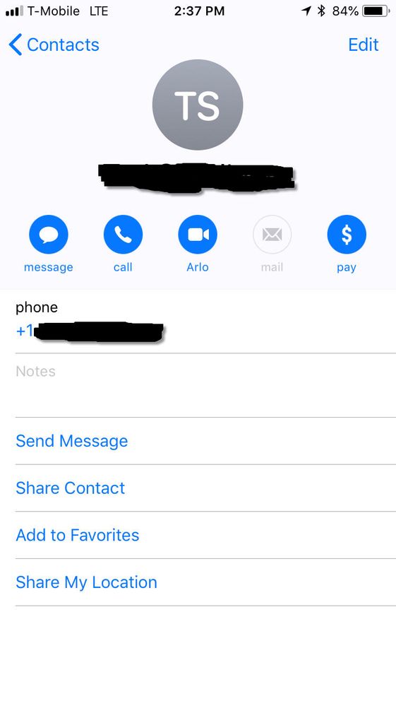

So I recently found a small handful of people in my iOS contact list have an "Arlo" label where it usually says "camera" under the third icon behind "message" and "call" directly under the contact's name when I open it. I am freaking out because I've got an Arlo camera in my bedroom-very private-and this is disturbing to say the least. However, when I go to my app settings, it says I haven't granted access to anyone-but when I click on the "Arlo" icon on my phone under the contact it opens the app with full control of viewing and turning cameras on and off and basically anything else you could want to do. But other people in my contact list do not have the "Arlo" icon, it is still just the "camera" icon. Need to figure this out asap thanks.

This is an iOS feature that prioritizes video call capable applications for contacts (apps like Skype, Facetime, etc. appear here) as you can see on the screenshot. iOS prioritizes the app displayed based on frequency of use and eligibility. For example, a contact with an iPhone might have Facetime displayed here if you regularly use Facetime with that contact. The last app used will be shown here. If you tap and hold the icon, you can select another app. Rest assured this is NOT sharing Arlo cameras or any Arlo information with contacts in your contacts list.

Hey everyone,
Could you provide a screenshot where some iOS contacts have an Arlo icon so I can take a look?

FYI:  In iOS, the contacts all have a "video" icon, that is grayed out (at least on mine) for a second or two.
"normal" contacts, the video icon will turn blue after 1-2 seconds
Random contacts, this icon will then turn into a blue Arlo icon.
khurni
One more thing we found out:
It seems that if the contact is an iPhone user, they show "normal" (video icon).
If the contact is an Android user, then they show as "Arlo".

Thanks for providing that screenshot. Try to update to the latest iOS version (iOS 12.1) to see if the "Arlo" text goes away.
rob170
I've already updated, I updated to 12.1 right after I noticed this issue. It is still going on. Taking screenshot now.IMG_21CAAA859B4F-1.jpeg
