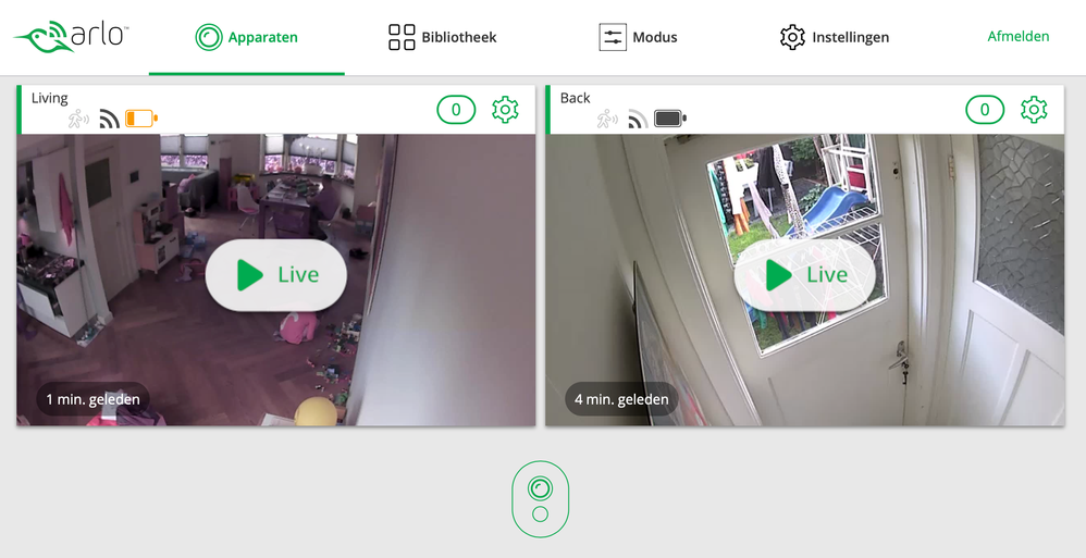

my Arlo has a nasty color cast in red tint
I thought it was a white balance issue, hence my request for an add on of a whitebalance slider
but... it seems to be a IR filter issue.
It seems that an exchange of Netgear is possible
so Netgear? What to do?
