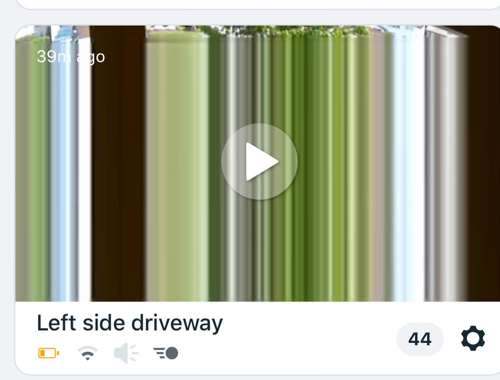

Hi. Does anyone know why this happens? My cameras only recently went bonkers. About half of all library records play with the image partially or completely covered with green screen, and appearing as smeared thumbnails. The problem affects both of my cameras pointed towards my entryway so I’m inclined to think it’s a network/software problem. Solutions welcome 🙂

Well, it's video corruption due to lost data in the recording.
But that of course doesn't explain why there was loss.
I get multi-color vertical lines in most of the images from one camera. It's NOT solar related bcause my camera is pointed north and is under the eves of the house. The other cameras don't exhibit this problem. I have had them about one month. This camera is using battery power much fastr than the others as well.
Any ideas how to fix this or what causes it?
Can you post a screen shot (or share a recording)?

The general cause is that some the bits in the compressed video stream aren't reaching the storage (whether cloud or local). Normally the compression of each frame is sending the differences from the previous frame. If anything is lost for a frame, then that frame can't be decoded. Because each frame builds on the previous one, the errors propagate and you quickly get a mess.
Possible causes of loss include
- poor connection quality between the camera and the base
- poor connection quality between the base and the cloud
- the camera not delivering the full initial I-frame in the video
- lost data due to other bugs in the camera, base, or cloud.
So firmware issues are certainly a possible cause. The puzzle for Arlo is to figure out exactly where the loss is happening.

This is a symptom of a corrupted video stream (either due to a connection issue, or a firmware bug when transmitting an I-frame).
I'm seeing it fairly often in my own cameras, so I am suspecting there's a bug introduced somewhere.
