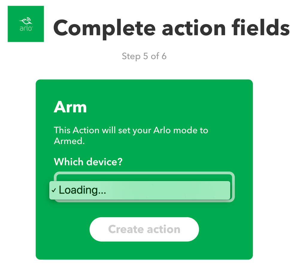

Case Summary: IFTTT issue_Unable to select Arlo Device just shows LOADING in creating an applet

When I create recipies with IFTTT, it will not fetch m list of cameras for Actions (ie arm, disarm, record) - it just shows `loading...`. It DOES fetch the list correctly in the triggers (motion, batteries low). I have tried unlinking/relinking account - no change.

- arm arlo camera : not working, stuck on "loading"

When trying to configure a new IFTTT applet, I cannot choose a camera to trigger a recording. It just hangs on "Loading..." in the dropdown box. See attached screenshot.
