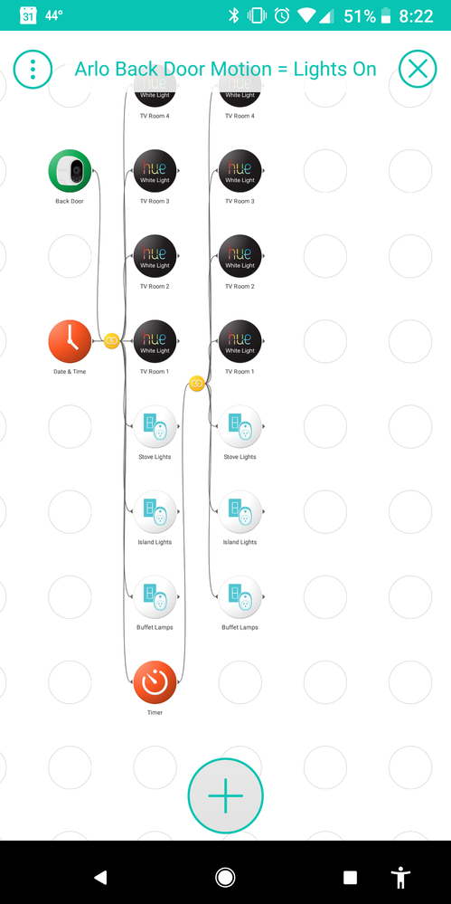

BTW, I attached a screenshot of one of the more advanced flows I've set up in Stringify. If it's night time and my arlo camera detects motion, it turns on all my smart lights (hue bulbs and tp link smart switches) for 5 minutes and then turns them back off. That just gives an example of all that Stringify can do.
. I'm using Lifx bulbs.

chrisngrod wrote:
I have something similar, but I wish it could take into account the original state of the bulb. If on then do not turn off.
If you have SmartThings, you can easily do that.
jmkirsch wrote:LIFX doesn't provide any triggers; only actions. That's why you can't take into account original state. That's a LIFX issue; IFTTT and Stringify can only leverage what the vendor provides through their API. Ex: Ring cameras only have triggers (motion, or button press), so no way to disarm.

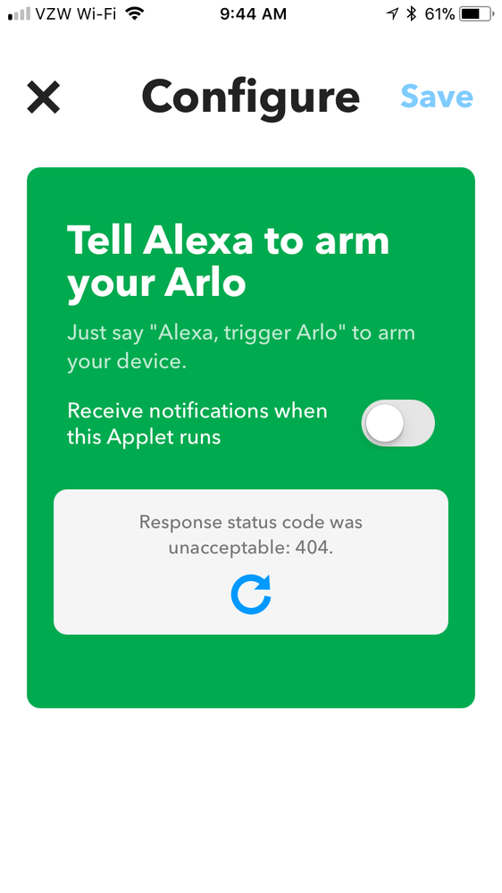

When trying to configure or change a current IFTTT applet via the browser or mobile app, the Arlo components show errors. At one point trying to configure using do see a 404 for the arlo component.
Confirmed IFTTT Oauth/login, and all other non-Arlo in the system work. Is there a current (new) issue with IFTTT and arlo?
