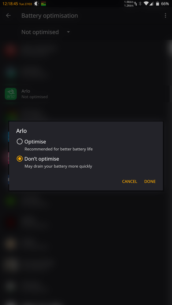

OK, maybe progress here with the latest update (2.4.10) !
I've managed to keep the session signed in over the whole morning ! This won't allow me to test geofencing until I'm back home tonight, but at least the "session timed out" message seems gone.
What did the magic was to whitelist Arlo app in Android's battery optimisation list, set Arlo app to don't optimise (see attached screenshot).
I will report back once I'm at home later today, hoping to seen geofencing back to where it was, ok-ish.

Obviously this won't avoid you manually killing the app. I had that set as well from start on, just it got lost when I uninstalled to reinstall the app as suggested (and maybe this is the case for others, why I mentioned it).
The new app at least now, if not optimised, isn't prone to session timeout anymore. If geofencing is back to more or less working I will see tonight.
That this is not THE solution is obvious, but unless Arlo app gets done properly as you suggest, this is the only thing we as users can do to workaround so far.
