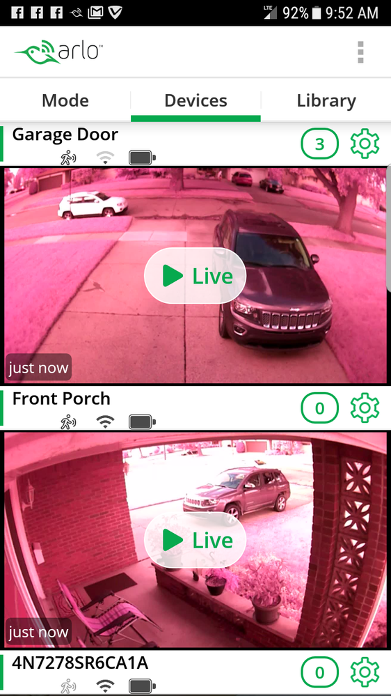

Am I missing something? Is it possible I messed up some setting somewhere?

If you had to return your Arlo camera because it had the “pink/red tint” issue... it wasn’t an Arlo Pro. The Pro versions do not have the same design and therefore do not suffer from the tint issue.
Exactly right

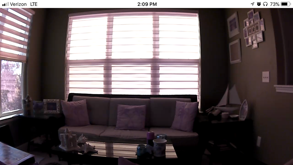

Please post how to fix the red/pink tint/hue that people are having on their cameras. My cameras were up for 2 months and now 1 of them has this pink tint on it.
Hi I have the same problem as quite a few other people being the red/pink picture on the camera. Tried opening and closing batteries and resetting several times without any luck. Now 2 out of my 4 camera are affected.

This is a known issue involving an IR filter. Take the camera back to where you bought it and get it exchanged.
I have had 3 of my camera's turn pinkish red.
I've had that happen to more than one comaera. Get a replacement.
