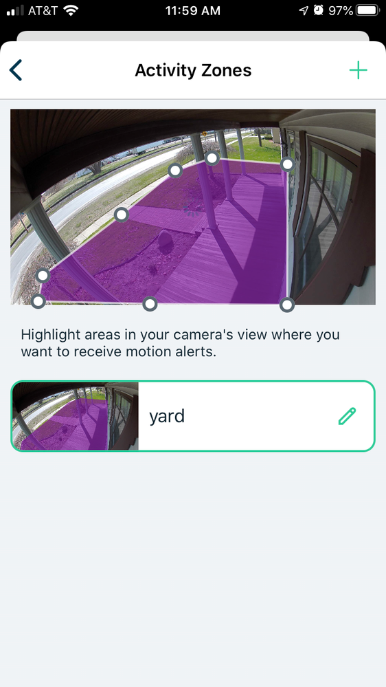

Thank you James, I did get that one working finally, I walked outside and it saw me and from then no issues, now my front one is sending notifications and recording every car that goes by and I have a zone set for just the porch and yard but was told it could be due to the road being with in 25 ft and there is nothing I can do I just shut off notifications for that camera and will delete the 100 or so clips each night unless you may know of something else. I did remove the camera and re synced it, I would attach a picture but it says it won’t allow as my phone save in jpeg format. Thank you for all the help.
StephenB
Of course activity zones are supposed to solve that problem.
It looks to me like you could adjust the camera a bit more downwards, and avoid capturing the road (or at least most of it).  I also suggest shrinking your activity zone - creating some more margin.  You likely are particularly interested in the porch, so you probably don't need to include up to the edge of the sidewalk.
You could also turn off notifications for vehicles (and maybe "all other motion").
One thing I've noticed is that even with activity zones, I will get notifications at night - generally caused by the lights on emergency vehicles or sometimes trucks.   The lights illuminate the activity zone, and the system can treat that as motion.
Heatseeker519
I moved the camera to over my door and that pretty much stopped it, I do get the occasional at night like you mentioned from car lights and in the early morning with the sunrise but neither of those are a big deal. Thanks for the advice and I guess I should have updated my post. Learned real quick though that placement is everything.
