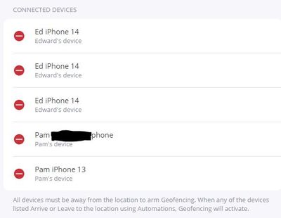

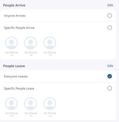

What changed? We went on vacation for a few weeks and now geofencing isn’t working for any of our devices regardless of the settings.
currently showing two phones for both of us.
Can you please provide more details on what it is you are seeing?
I have selected individuals as well as everyone and nothing I do helps the geofencing to recognize when we come or go. Below are screenshots from the app on my iPhone as well as from the web version on my computer
@BrookeN wrote:Can you please provide more details on what it is you are seeing?

@ed_lipscomb thank you for providing those screenshots. I passed this on, I will let you know as soon as I have an update.

Any updates on mine BrookeN?
@ed_lipscomb the development team is currently investigating the behavior you are seeing. I will reach out as soon as there is an update.
