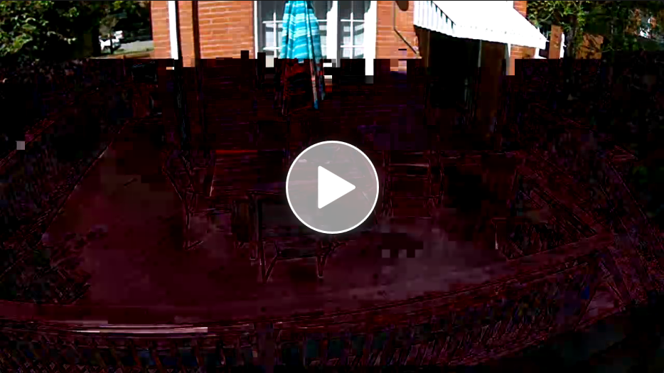

Here's you another example: Live video on Pro camera, no movement in front of it, heavy smear and pixellation, 30 feet from the base with full bars coming in at 310kbps. Completely unusable video, you cannot even see the truck that's parked in front of it. WTH, ARLO??? COMPLEX MOTION, HUH? Do you think we're idiots???
Another screen shot from today, at this point it is worse than useless.
VMB4000r3 and Arlo Pro 2 Cameras
Some of my info over time. Utterly useless at this point.
