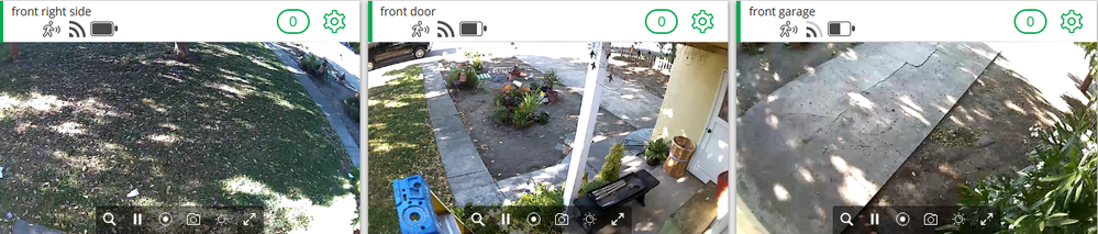

This photo sure came out huge! Anyway...the camera is only picking up motion from the red line to the right; it doesn't pick up anything that moves on the left side (where the "x" is). It has missed anyone coming down the driveway or going in/out of the back door. If we go out the back door and down the steps to walk behind the house, it notifies me once the "motion" reaches the red line, not before that.
I have it mounted about eight or nine feet up on the garage and it's angled a bit toward the right to catch the back porch.

I see this photo with no problem. It strikes me that 1) distance is an issue (25 feet max for people) and 2) motion on the driveway is to/from the camera rather than across the FOV.

Based on what I think you're saying as well as what I see in the 3 cameras' views, it may be tough to get what you need since you have a lot of the sun's IR being reflected and the moving leaves/branches are always going to be a problem for a PIR sensor. ABout all you can do is reduce sensitivity to minimize false detections while allowing people to be detected. Repositioning the cameras to look towards the house rather than out to the street may help if you have appropriate places to mount them.
