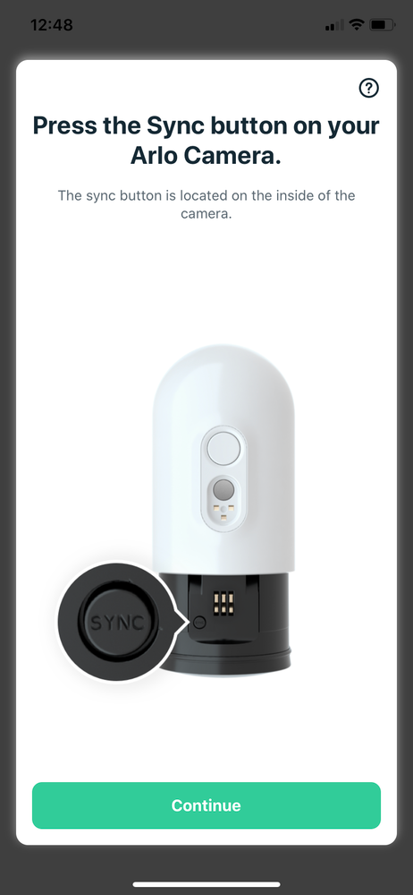

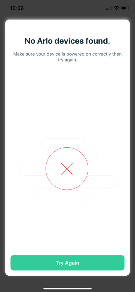

I tried resetting everything up. Base station is ok.( firmware updates fine and is set up) I Hit the (forget device) button for the 1 camera I have. It proceeded to search for camera.Tried to re-sync still can’t locate camera. It even flashes blue when sync in process on camera.

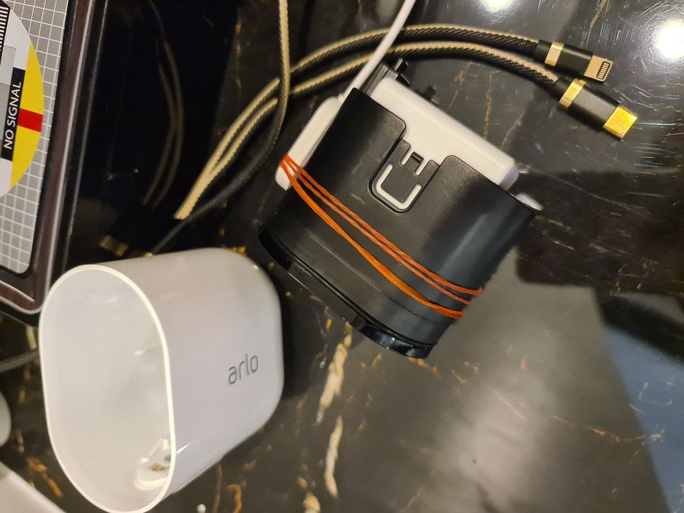

Took the cases off my cameras and attached the charger to the contact points with a rubber band. They now charge.
Ridiculous that I have to do this every charge but it is a solution.
Maybe a re-design by arlo next time, as it is a wide spread issue.

I agree its a design problem..this is how im charging my Arlo Pro 3 Camera now...never fail this way...Arlo, this is pretty depressing
