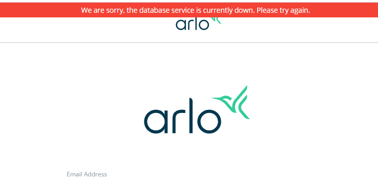

For anyone who is still having this issue, could you provide a screenshot that shows the error message?
Same issue. Screenshot attached.
