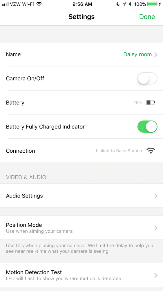

My remedy doesn’t involve pulling batteries but to merely go into app and turn camera(s) back on, from the setting icon(gear). Hope they fix this!
Elmw wrote:
Solar panel connected to Arlo Pro, worked fine until one camera in my setup was added/upgraded (Arlo pro 2), then even solar panel connected camera is going offline.
As previous post said, when camera goes offline, you don't see any option in settings to turn camera back on.
If it goes 'offline' and you are able to turn it on from the settings, then you don't actually have the problem being represented here. Your answer adds no value if I'm honest as most people know how to turn cameras on/off. When they go 'offline' and in a state of non-recovery you cannot bring it back by any other means than to pull power/battery, as has been said.
