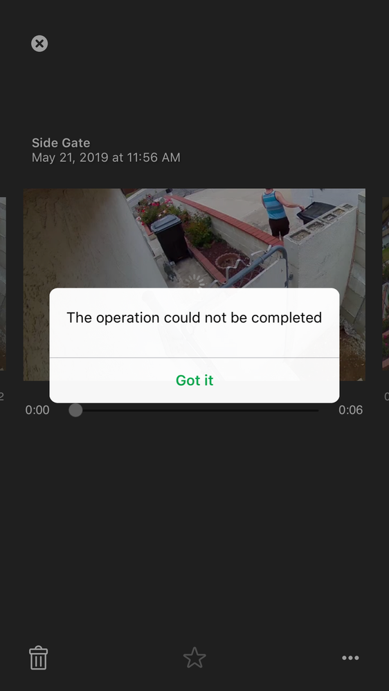

Attach a screenshot of the error message received.
- Attached

I have been having the same issue for the past several weeks that's been described here: On iPhone 7, when trying to play back recorded video, I get the message "The operation could not be completed. [Got it.]" Early this morning, I received a notice that a firmware update was required for the base station. I ran it, hoping this would rectify the problem, but no... I am still having the same problem. Very frustrating, especially as cameras are about 4,000 miles away! To clarify, it affects all five cameras, but there's no pattern: sometimes recordings play; other times they don't.

Running the latest IOS & Arlo Iphone app some of the library videos will not play. nGet popup message "The operation could not be completed". This just started last week on some videos while others play with no problems. I've deleted and reloaded app and I've tried to download the video to my phone but it does nothing. Also tried to download the .MP4 file from the website which it does but then cannot play on Windows Media Player. Error messages about incorrect formats and CODECs.
Whats going on?
The faulty recording on the cloud is missing the audio stream but the mp4 file header says that it exists but has no format or codec details, hence the codec error.
The android devices obviously ignore the false header and play the video without the error except that the recording is missing the audio.
