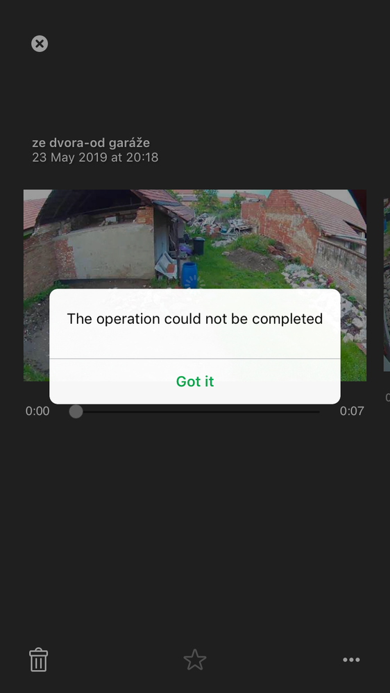

I keep getting this message operation cannot be completed at this time does anyone know what this means

I am also getting the operation not completed both on trying to play videos and download them. I get the cocoa -1 error as well when I try to download a video that gives the operation did not complete error. This just started after losing videos during the May 21 outage that affected me.
I just started receiving this cocoa error-1 message yesterday as well and could not play or download the video. This was very frustrating as it was a late night alert with some strange person. I could not dowload or view on iphone 7. Thankfully I was able to log on from my PC using Google Chrome and could view it. However, when I downloaded to PC it would not play on windows media. Today I can view some videos while others I can't (on app fm iphone 7). It would be great if they can fix this issue.

The cloud mp4 header says that there’s audio so your devices try to play the audio and present an error trying to play or download.
Chrome can download the file and can play the video stream but the flash player’s sound just gives a burp at the start.
Windows media player needs the correct codecs installed to play the video so not likely to happen.
If you have vlc player installed on the pc it will play the video but throws a audio codec missing error, audio is not played as there is none to play.
Android devices can play the recording I believe as they ignore the missing audio stream flagged by the file header by default.
