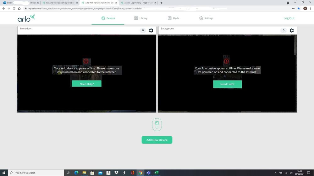

My pic is the same as yours showing offline.... but it's a bit weird.... Web access/win10/FireFox
The 4000 base cameras are the ones showing offline( all leds green ) but the 5000 base and cams are fine.
But it also show a Q camera ( wifi direct ) and a Baby camera sometimes offline ( wifi direct ) too.
But they still are active tho listed as offline.
Every now and then getting an Orange bar stating " the session has timed out" when this happens.
It seems to be more of a fail to properly display the actual settings of status info over an offline issue

Ours says offline too sometimes now, even though recordings go on and all 3 lights are lit on the base. It will be fine one time and jacked up 5 minutes later or 5 hours.
Using the my.arlo.com web page, my base station and cameras all show up as offline most of the time.
Reboots, etc. don't matter. Either I see three solid green lights, or the middle light will blink, so it should be working.
When I motion activate a camera, it turns on the IR, and appears to record me. When moved away, IR and recording stop All wile the camera and base station appears offline on your website.
Immediately afterwards on my router's console I see network traffic going in/out of the base station to the internet --- after the camera stopped recording. The camera and base station all appear "offline" from the website.
And a while later I check, there is the recording in my library, but everything is still offline.
It appears your my.arlo website is very very broken

It appears that my base station and cameras are still operating correctly because i get alerts and recordings. I'm wondering if the issue is related to the interface and relay taking place between the app/online webpage and the servers since it appears that all system base stations communicate through the Arlo servers in order to display images and data on the app or online. Perhaps the user should be able to communicate directly with the base station without the delay of routing all things through the Arlo servers. Perhaps this is something Arlo needs to consider with a high priority. Perhaps a major hardware upgrade on their end would help greatly. Just my view on this matter.
Cause of Browser, Across Chrome and MS Edge
Arlo team, you have a CORS Cross site permission issue causing the website to fail to load properly. (Request timed out and/or things does'nt load in devices). You need to configure headers to allow myapi.arlo.com and my.arlo.com
Fire up F12 on with either browser the error is the console.
i.e: obfuscated the ID's
Access to XMLHttpRequest at 'https://myapi.arlo.com/hmsweb/users/devices/automation/active?eventId=xxxxx&time=xxxxx' from origin 'https://my.arlo.com' has been blocked by CORS policy: No 'Access-Control-Allow-Origin' header is present on the requested resource.
Access to XMLHttpRequest at 'https://myapi.arlo.com/hmsweb/users/devices/notify/xxxxxx?eventId=xxxxxx&time=xxxxxx' from origin 'https://my.arlo.com' has been blocked by CORS policy: No 'Access-Control-Allow-Origin' header is present on the requested resource.
