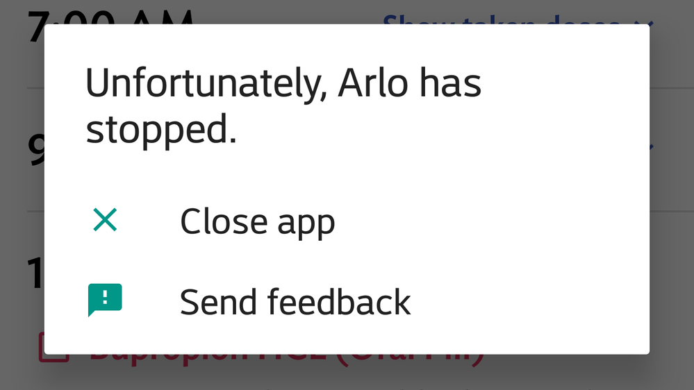

Here is my screen shot if they don't believe you.
Purchased Arlo pro 2 in Mar of 2018, worked great until last week received a message on Samsung galaxy express prime phone that Arlo has stopped. its working great on my Samsung S8. I uninstalled the app and reinstalled still not working, any suggestions?
I'm sure they believe me, I sent them the screen shot. People have already posted the same screenshots on here. I think they are just trying to buy time and stall while they figure out what to do about it. Calling them really did nothing at all. I get the feeling that maybe it is not enough people complaining for them to address it and they are not losing any money from it so there is no rush on their end for a solution. I did leave a 3 star review of the system on Amazon just to let others know that they are not too concerned apparently about doing testing for updates or resolving the issues when they find them.
Help - I have uninstalled app - reinstalled app too many times in the last couple oif days and system is still crashing. I have had Arlo on my Samsung J7 since March 2018 - no problems like this. All I get is a screen that says "ARLO has stopped" Send Feedback"

You're not alone. It seems to be an issue with our Samsung J7 Neo phones. I keep having to uninstall the app and then go to www.arkmirror.com and search for Arlo, then scroll down to the Oct. 30, 2018 update and download that. Then on your phone, check notifications and you'll see the download and when you click on that, you get the option to install. It's a large pain in the backside. I'm thinking I need a Ring system instead 😞
Yes. I just found out how to clear cache and data and it didn't help. I loaded the arlo app on my new tablet and it is working on it. I am now suspecting it is the Samsung J7's that have an update issue. I'll be swinging by Costco and finding out at the kiosk if someone there knows how to fix it. Whatever I am able to find out, I will report back.
Welcome to my world. I have a Samsung J7 that I bought because I needed an affordable Android phone to use with this camera. I was happy with my previous Windows phone, but Arlo is antiquated and doesn't support the Windows platform. I have been having the same issues. If you uninstall the app from your phone, then go to the internet to www.arkmirror.com and in the search, look for "Arlo" and scroll down past a ton of Google ads and you'll see a list of prior updates. Choose the Oct. 30, 2018 and on the right click to download. You'll scroll down some more and see something about available Arks (I have no idea, I'm a senior citizen). Choose the Oct. 30, 2018 again if prompted, and it should begin to download. Give it a few minutes. When it's done, you should be able to do the pulldown at the top of your phone for notifications and you'll see the recent download. Click on that and there's an option to install. Do that, and then it will tell you to open. Do that, and you should be functioning again. You may have to repeat this daily until the Netgear people get this resolved 😞
