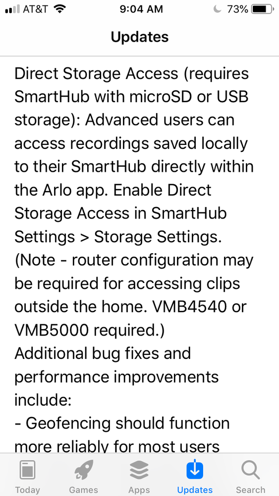

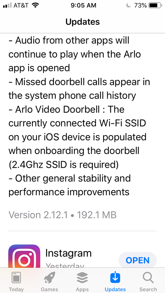

Just got another Iphone Arlo update 2.12.1. See attached photos of update text. It appears to me that Arlo is trying to fix the problem by--ultimately--allowing advanced users to access recordings saved locally to their SmartHub directly within the Arlo app. This would seem to me to remove the need for Arlo to pay for the massive amount of stored video files the Arlo system has to handle. Only issue is that it seems to require at least a VMB4540 or VMB5000. So then I would say that all the rest of us with recently purchased VMB4500 models--and some lower--should be sent the later model base stations to fix this terrible problem. Then they might get their reputation back.
If you look at this from the larger view, Arlo separated from Netgear, their stock severely dropped in early 2019 which must have made the cost of maintaining their video files prohibitively costly. I would be happy to have the burden of video storage off of Arlo and placed in an accessible usb storage device if that solves the problem.
They announced that a year ago (see https://community.arlo.com/t5/Announcements/Local-and-Remote-Access-to-Local-Storage-for-Arlo-Ultra-... ). Though this wasn't intended to be a feature for advanced users only. It's the long-term remedy to the strong negative reaction of the customer base about Arlo requiring a paid subscription for cloud storage when they launched the Ultra. The short-term remedy was the 12 month trial subscription. The Pro3 was in the same situation, so they launched it with the 3 month trial subscription as the short-term remedy.
The 7 day free recording is still available for the older WireFree, Pro, Pro2, Baby, and Q cameras - assuming you have 5 or fewer cameras in the account. ( https://kb.arlo.com/88/What-are-the-available-Arlo-subscription-plans-and-how-much-cloud-recording-i... ). So there is no change there either.
The potential holes here are
- the video doorbell doesn't have any free storage option at this point
- people adding pro3 or ultra cameras to old bases will need to purchase subscriptions (or get a new base).
FWIW, I don't believe this is directly linked to stock price. I think it's more about profitability (which is of course indirectly linked to stock price). A new entrant into the market can offer free cloud storage - it costs little if you don't have any customers yet, so you can fund it from new camera sales. But as the installed base gets larger, the storage costs go up - and eventually you can't fund it that way any more. Add in 2K and 4K cameras (which use higher bitrates), and the costs go up even faster. Shifting the storage out of the cloud is a good solution for both Arlo and the customers (who get more retention then they had before).
Just my theory on this - I don't work for Arlo, and have no inside information.
@StephenB Thanks for that info. What's not clear to me is if the online (remote) accessibility to the videos will work with the Pro2 Cameras and 4500 Pro2 Base Station. If the 7-day free video system was actually working correctly, i wouldn't need the remote access. But given the situation, if I have to purchase either new cameras or base station--and if many others do as well to get remote access to the local storage--then this will constitute a breach of trust with Arlo's customers. As I read that software update, it does seem my system won't work with this new remote access. Those who paid a few thousand $$ for the Pro2 system I think should expect to get 7-8 years of service from the investment.
At present it requires the 4540 or 5000 base. I have no idea whether that is a business decision or a technical constraint.
But overall the 4000 base is more capable than the newer 4500 (for instance, the 4000 can handle 2K recording, but the 4500 can't) - which suggests that they took some cost out of the 4500, which limited their ability to add new features to it.
