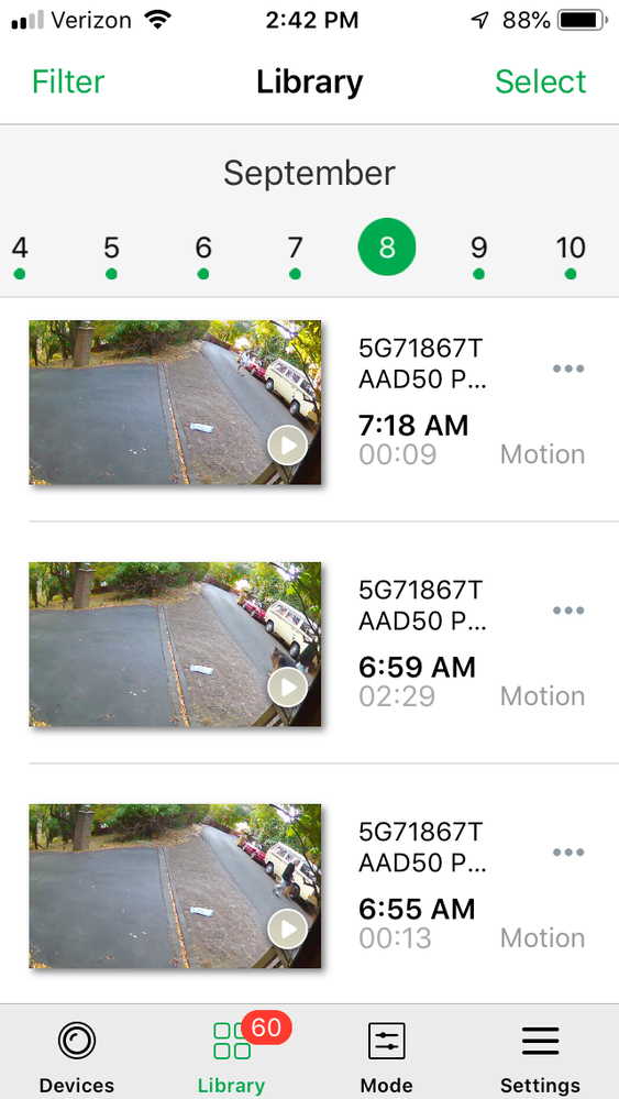

About 1/3 of the recordings Play for about 10 seconds and then the video freezes but the audio keeps playing. I have tried downloading the recording but the saved file is no different. I have two arlo pro 2 cameras both having the same problem. They are both hard wired. I use the arlo app on an iPhone8. The audio does not seem to be in sink with the picture either.

So my issue started with noticing that my videos don't record for set 120sec. They would record all random lengths.
