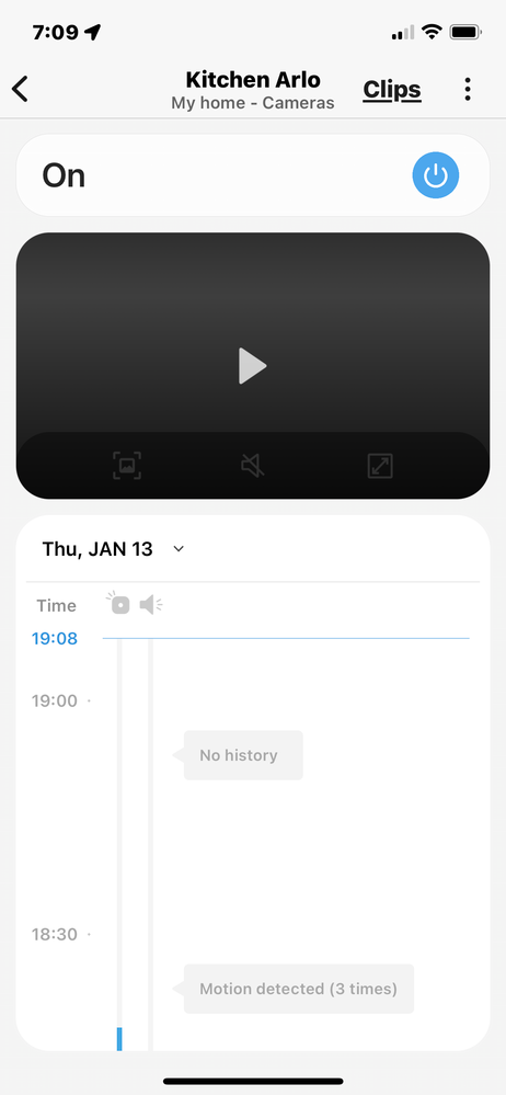

So, an update on my report from yesterday. It was working properly until this morning. I no longer am receiving motion or audio alerts on my cameras again. So, it definitely appears this is still not fixed. It did work for a good 12 hours or so though.

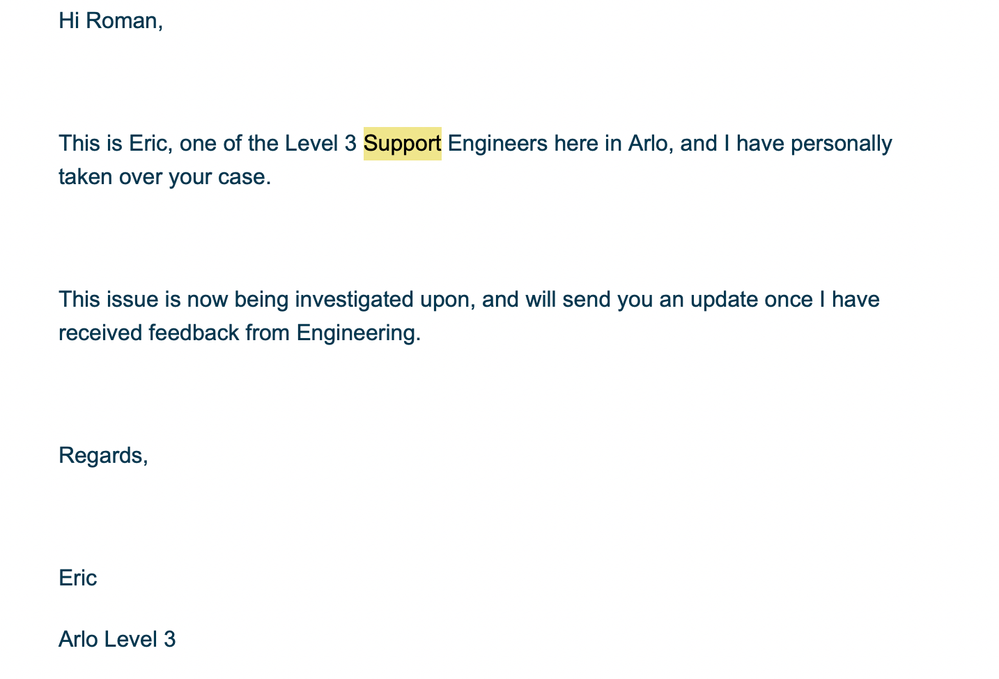

Support stopped responding to my messages after January 3rd. The last message was from Eric (level 3 support engineer). Interesting.. does anyone from the support come to the forum?
Yup, same as everyone else has said. Motions stopped coming through overnight.
Same situation. Set up cameras in the morning. Everything works as needed up until late evening. Wake up next morning and everything has stopped working and need to go through the entire set up process again, including setting up my automations again. Seems as though things stop working overnight here…during a time when I need my cameras the most - overnight. But hey…at least I’ll have security footage to give to the authorities AFTER rather than preventing things from happening in the first place.
