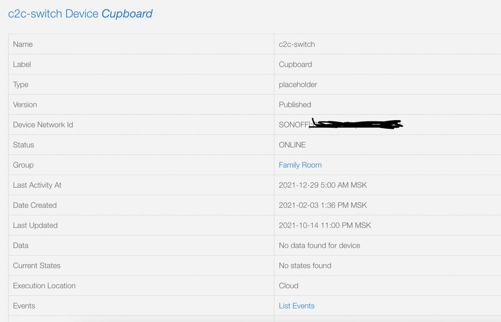

it doesn't mean anything! Many devices have placeholder in Device Type! For example, Tuya or Ewelink switches!
