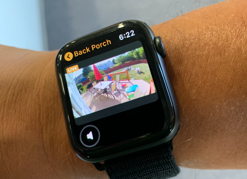

Someone actually has live streaming video on an Apple Watch on WatchOS 6 beta? I can't get that to work on WatchOS 5 or earlier. I have NEVER been able to get that to work on the Arlo Baby either. (I take that back. It will work if I turn off wifi and bluetooth on my iPhone.)
Maybe there is hope. Maybe WatchOS 6 holds the key! Plus now they will have a lot more customers trying to view on their watches.
WOW! Good things come to those who wait!
