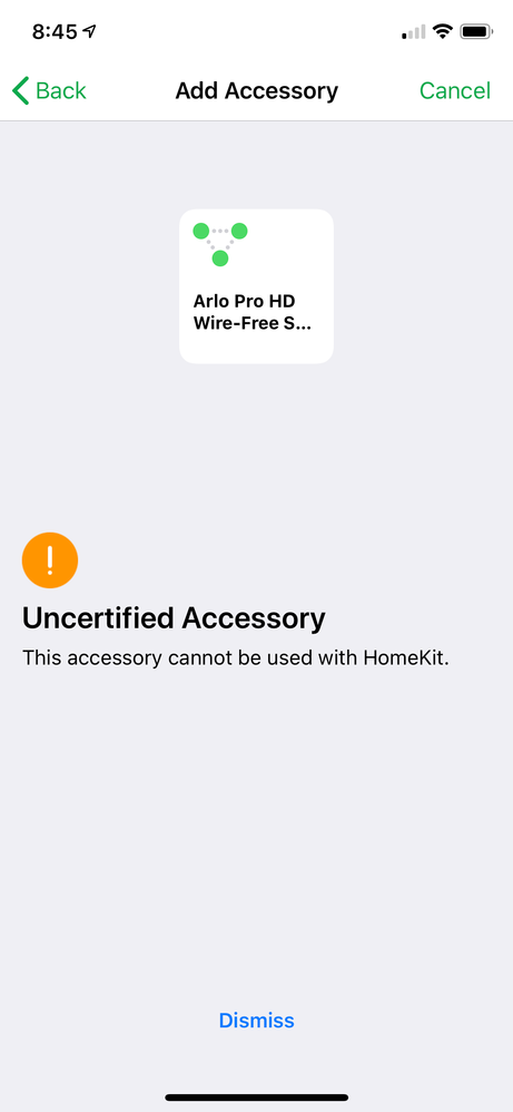

I am also on my home network and keep getting uncertified accessory, as see in the screnshot.

IDK why you’re getting that. It looks like you took that screenshot from within the Arlo app. There should've option for you to proceed despite the accessory not being certified for HomeKit. I have attached a screenshot that I took from within the Apple home app. Noticed that it says the accessory is not certified but I was still able to add it. What model Base station are you using? Did you check to see if there were any available firmware updates for it?
Thanks for the response. There doesn't seem to be any way for me to add it anyways.
My Base Station is VMB4000r3 on Firmware 1.14.0.2_2776. There are no updates available on the firmware or any of my cameras (listed below).

After switching to iPad on iOS 12, everything seems to work fine in homekit. I agree, set up in arlo app first. Then you can view and rename cameras in homekit.
