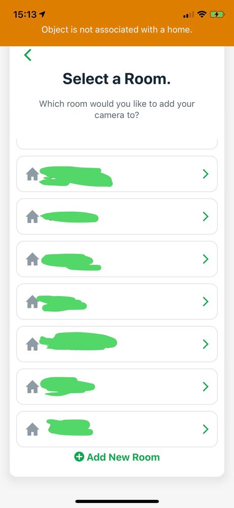

It created the room, but then when I tried to select ANY room -- the new one, the "Default Room", or any other room -- it gave me an error up the top of the app in Orange:
"Object is not associated with a home."

Here's the sad error message that dashed all my hopes and dreams. I don't know if it's just me -- because I have two "Homes" in HomeKit and/or because I tried to add a new room. But I haven't been able to get it to show me the "Add to HomeKit" to try again.
For what it's worth, adding the new room ("Outside") DID successfully add it to HomeKit, I can see it in the other HomeKit apps (it's empty)
