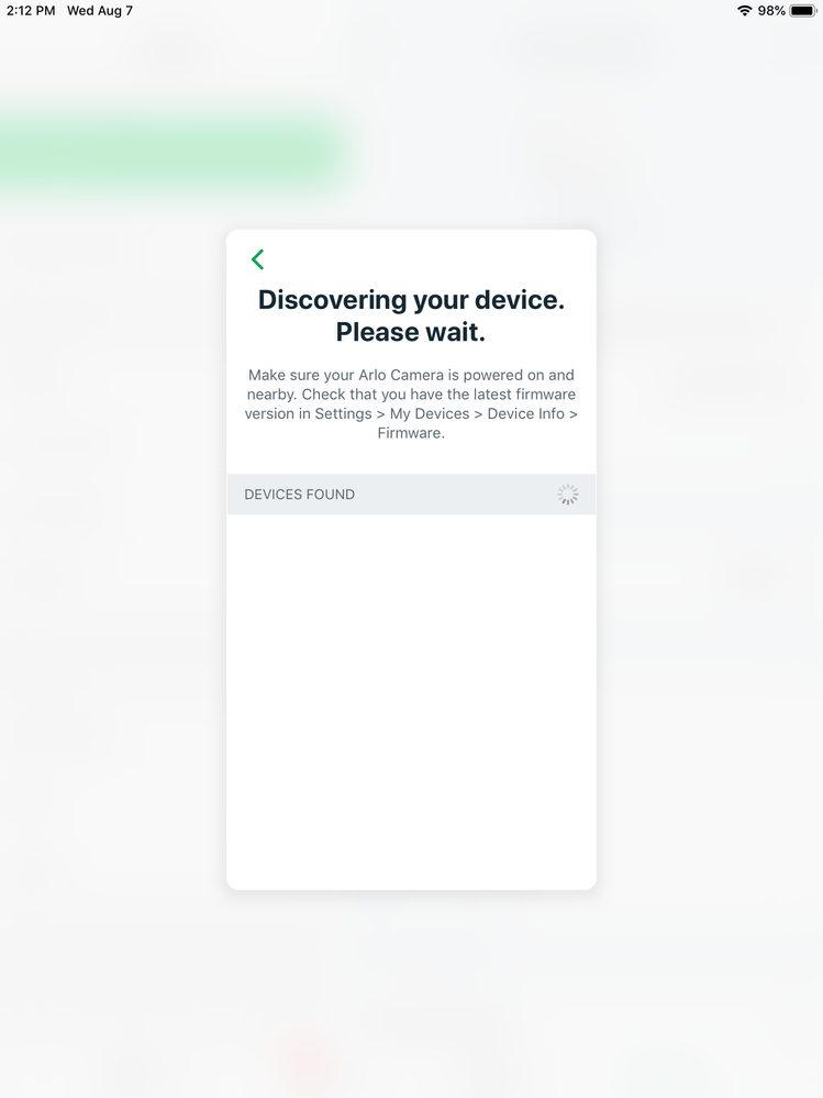

When trying to add Homekit. I select my hub on the Arlo app. Select Homekit Setup. I just get the above message. Lower down it says a Devices found but it has a circle that keeps spinning.
Everything is up to date. Hub and app
I've power cycled the hub
They are on the same network
Cameras work fine through the Arlo app.
Screenshot added
