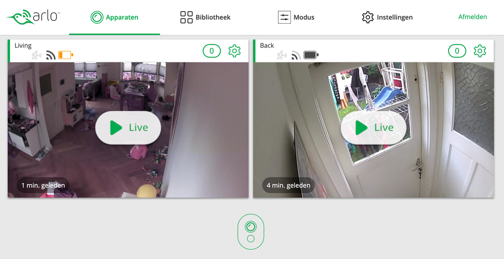

I took out the batteries, charged them all night, and put them in. Also rebooted the whole system. Attached screen shot.
