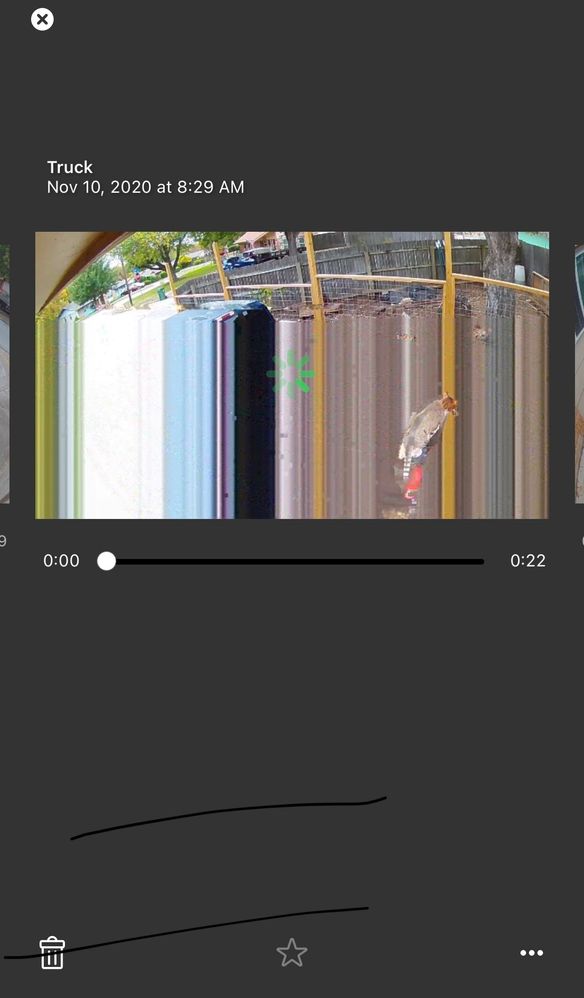

Hi. Does anyone know why this happens? My cameras only recently went bonkers. About half of all library records play with the image partially or completely covered with green screen, and appearing as smeared thumbnails. The problem affects both of my cameras pointed towards my entryway so I’m inclined to think it’s a network/software problem. Solutions welcome 🙂

It seems to only occur on 1 of 4 cameras. Interestingly, in the attached photo, you can make out a cat and 2 chickens within the smearing, but when playback starts it is solid green.
