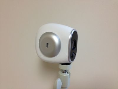

Does the older VueZone outdoor mount work with the newer Arlo cameras? Or do I need to buy the VMA1000 mount?
Any mount with a standard camera 1/4"-20 socket will work.

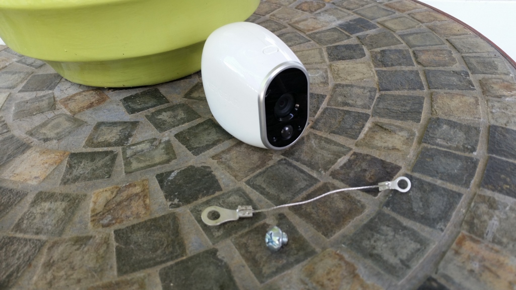

Picture of the camera in place secured with a cable lock.
While not totally theft proof, I did manage to make our driveway camera more secure.
I too have done what most of you suggested, and thus far it works well.
I have secured some to tress as shown below.
Mount Kit (2 mounts come per pack)
Lock (actually just a 15 inch firearm lock)
